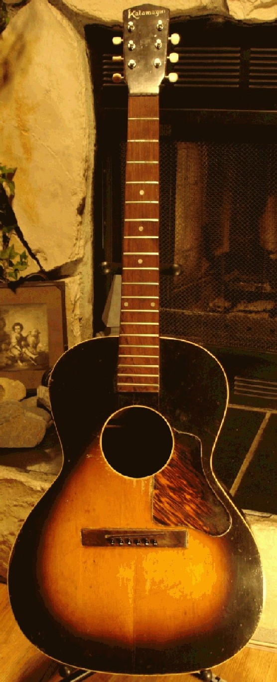

First time for uploading pictures. If successful - this is a front view of the KG-14. I was changing strings when I had to confront some of these issues. Decided not to re-string until I could do something. There are 5 other pictures that will reveal the need for a new nut, new tuners, new saddle, bridge pins, and probably new bridge. There is a nasty crack up the back - that didn't show up until a few days after I got her. At least I didn't notice it. Can't help but see it now. The other issue I'm now looking into is the bridge plate. It feels rough, and the things all the way across the top from side to side. Is that common for a ladder braced guitar - or is it more likely to be like an X braced and only under the bridge?

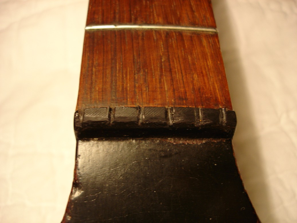

Judging from the damage done to the headstock finish at the foot of the nut, I’d say this isn’t the original nut. I appears to be made from plastic. It certainly was crudely made, There are sanding (or file) marks that didn’t show up in the photo, that are left over from shaping the nut. The slots are way too deep, too wide, not to mention all chewed up. The third (G) string, open position, is not high enough to even clear the first fret, unless you bring it to rest in a secondary slot on the side of /within the deepest slot for the string.
I’ve ordered a Stew-Mac bone nut.

Hey! That's an L-OO body. Cool! Definitely worthy!!! BTW, the nut scratches do show up in your photo, but I can't see the problem with the tuning machines, other than finding proper replacements.

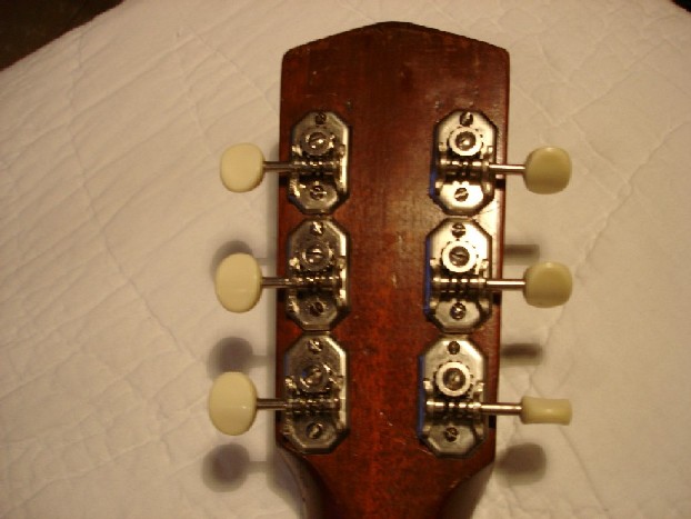

Whoever installed these mounted the left tuners on the right side and the right tuners on the left side; I guess because the hole matched up better(?). The results? In order to raise the pitch of the string when tuning, you have to rotate the gears in the opposite direction as you would normally expect (backwards). A nice little added quirk.
I would re-use them and just turn them around, except a few are tight at certain points in the rotation cycle. I think it is a quality issue with the gears not being cut right, so they bind at one point.
I have some Grover Sta-Tite tuners on order. And I think I'll fill the holes and install these on the correct side.
